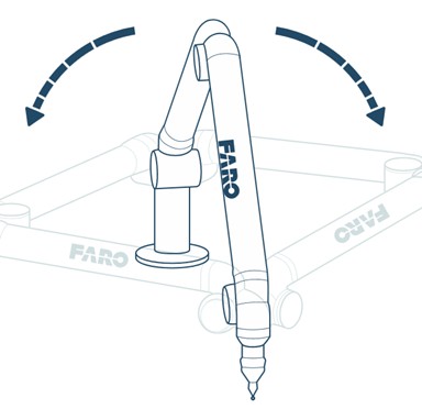

  1. Check the stability of the FaroArm mounting before you begin. Compensation takes the FaroArm through its full range of motion. If the mount is not stable, the compensation will not be accurate. Faro recommends the use of the 6mm probe for SPAT tests and Arm Compensation to reduce the chance of the probe slipping.
  2. Position the FARO compensation cone within 2/3rds of the FaroArm's reach, as measured from the FaroArm base.

  1. Use the on-screen coordinate system to position the arm height and ball probe. The repeatable point (e.g., stationary conical socket) must be the proper distance from the base of the Arm.
    When the height and distance align, the software proceeds to the next step.
  2. Follow the screen prompts to capture each of the positions required to compensate the device. For each position, rotate the probe to the required position by aligning the green dot with the X in the alignment circle. When the probe is at the proper angle, press the greenFront button and slowly rotate the arm elbow joint the range specified in the elbow indicator.
    Following successful capture of a position, the software prompts you to rotate the point to the next position for the next capture.

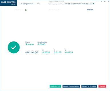

  3. When the compensation completes, the status displays. If the compensation meets your requirements, click Save and Exit. You can also restart the compensation.
    If the status returns as failed, ensure that your set up is stable, and do not apply excessive force to the arm while performing the compensation.

  6. Look at the before and after results. Click the Yes button to generate and save a detailed report of the test to a comma-separated values text file (*.csv file), or the No button to save the new arm compensation.
The new arm compensation will remain in your Quantum X until changed or reset. Click the Reset button to restore the FARO Factory compensation.
Repeat SPAT
Repeat the SPAT with the compensation cone or conical socket in a different location. This will verify the new arm compensation.
