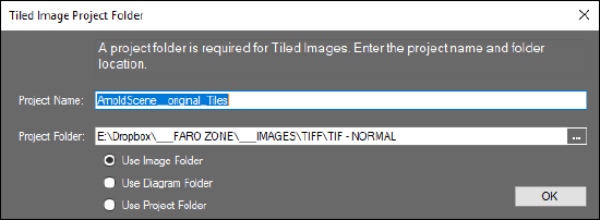

  2. Tiled images require a project folder. You will be prompted to name your project and give it a folder location or select a preset folder.
