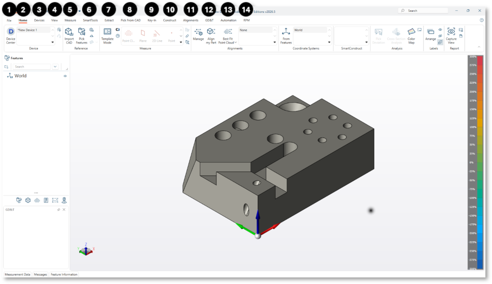

As review, at the top of your screen are your Default Tabs or Pages containing the basic commands that you will regularly use.
  1. File
  2. Home
  3. Devices
  4. View
  5. Measure
  6. SmartTools
  7. Extract
  8. Pick from CAD
  9. Key-in
  10. Construct
  11. Alignments
  12. GD&T
  13. Automation
  14. RPM

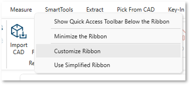

  1. Right-click the ribbon and select Customize Ribbon.

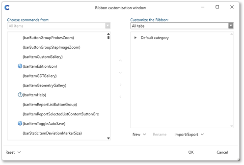

    You will be presented with the Ribbon Customization window:
    The left side of the Ribbon Customization window contains a list of all available commands.
    Note: it is not possible to select and use existing Groups when customizing a ribbon, only individual commands are available.

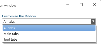

    The right side of the window contains a view of all existing tabs and the command groups for each tab.
  2. Highlight Default category or command, and click New > New Page to create a new (empty) tab.

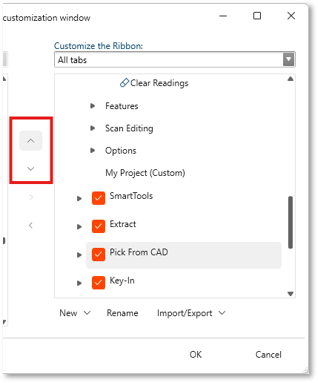

  3. Next, use the arrows in the middle to add, remove and rearrange commands.
    Highlight a command on the left side of the window, such as Polyline and click the right arrow button to add the command to a group, My Project, on the right side.
    OR
    Highlight a command on the right side of the window and click the left arrow button to remove the command from a group.
  4. Click the up and down arrow buttons to reorder a highlighted command within a tab.
