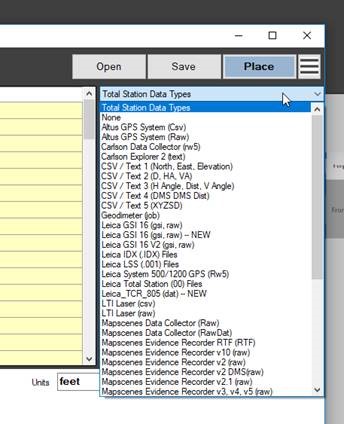

  1. Click the Coordinate Data Table tool.
  2. Click the bar labeled Total Station Data Types to display the list. If your device is listed, select it from the list. If it is not listed, use a common format like .txt or .csv.open place save.jpg
  3. Click Open and browse to find the desired data file.

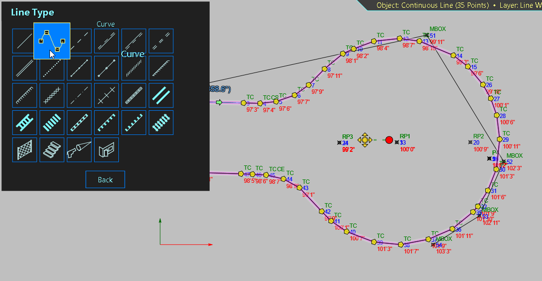

  6. If the points have descriptive codes associated with them, you can use those to automatically create line work between points with the same code. Just click the Auto Line Work button FZ 3D Auto Line Work.png near the Snap commands.
  7. When you are satisfied with the preview of the data, click Place to place it in your diagram.
  8. Once in the diagram, the points and line work are placed on separate, named layers so you can easily choose to display them, or not.
  9. If you use the Auto Linework feature, the points are connected with a Continuous Line. Click anywhere on that line to select it and click the Line Type button on the tool palette. One of the Line Type options is a curve. Select the curve to replace all the straight line segments with a smooth curve.
