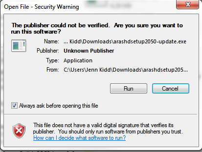

  2. A security warning will pop up. Click Run on this window.
    HD Security Warning

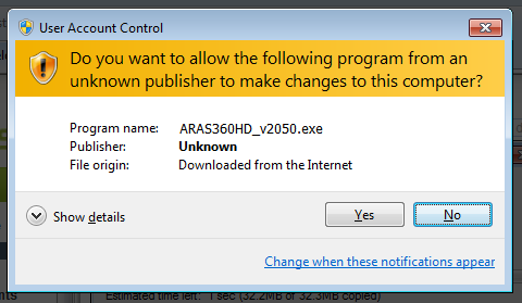

  3. If another security warning appears, click Yes on this window. Depending on your antivirus and security settings, this window might take a few minutes to appear.
    HD User Account Control
