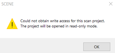

Error - Could Not Obtain Write Access for this Scan Project
Overview
The error Could not obtain write access for this scan project, while attempting on-site registration can be caused when using outdated firmware with a FARO® Focus Laser Scanner.
Download the latest firmware for your scanner to correct this issue.
