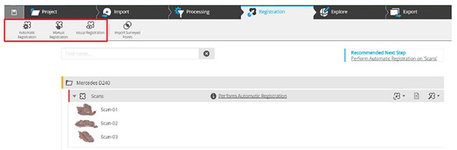

Registration of your Scan Data
  1. You can access the Registration menu by clicking on the button Registration. Here you can choose between Automatic, Manual and Visual registration. You may want to choose Manual Registration if you haven’t worked with targets or limited overlapping areas.
  2. Select your cluster scans and click on Select Scans. Here you can select your first and second scan and click on Mark Targets.

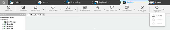

  1. In preparation for the export, create a Project point cloud. Go to Project Point Cloud> Create. Then save your project.
  1. An options box appears. Here you can eliminate duplicate points, homogenize your point density or apply
    a color balancing. Check your boxes and click on OK. You will receive a message when your project point cloud is finished.
