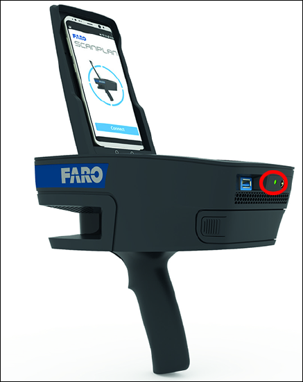

The FARO® ScanPlanTM power button and LED light will communicate hardware status and error information during operation.
ScanPlan Power Button Modes
Light Pattern Meaning
Blink-Blink-Pause Device booting
Illuminated Device is on
Blink-Pause Device is shutting down
ScanPlan LED Modes
Light Mode Meaning
Blinking Green Battery charging
Green Battery charged or firmware update
Blue Device is on
White Device is mapping
Red Device error
Orange Very low battery
Blue-Red-Blue Device failed to boot.
