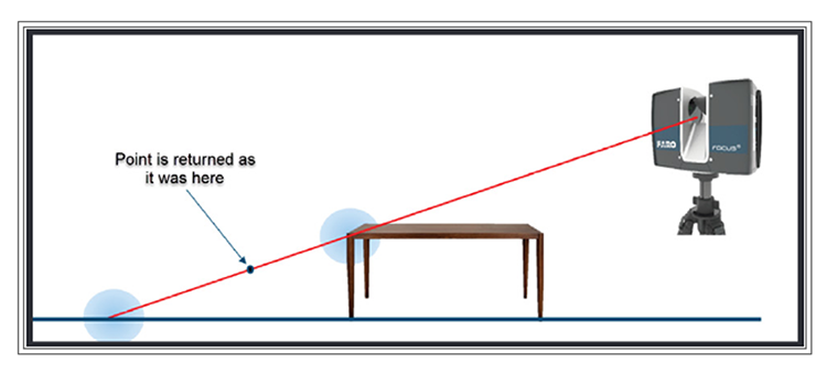

The edge artifact filter eliminates edge noise from scans. Edge noise is due to the thickness of the laser line. The laser might catch a point on the edge of a table and on the floor which causes the point to be returned in the middle, as shown below.

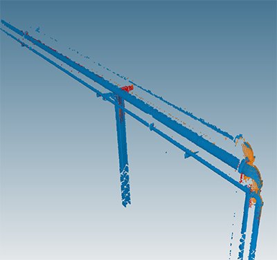

This filter is very useful on curved objects, such as piping. It’s highly recommended to always use this filter.
Examples:
Before
After
Before
After
