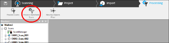

  1. Click Process Handheld Scans on the Processing ribbon.
