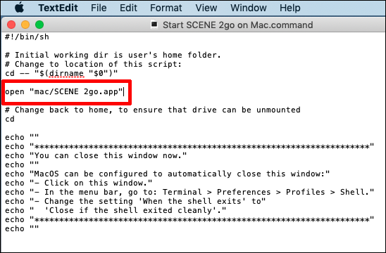

  3. Right-click on Start SCENE 2go on Mac.command, and choose Open With > TextEdit.
  4. If prompted, click Open to confirm opening the file. This may require the user to enter an administrator username and password.

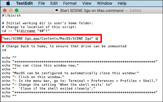

  5. Replace the line open "mac/SCENE 2go.app" with this line: "mac/SCENE 2go.app/Contents/MacOS/SCENE 2go" &
    Note: You must include the quotes and ampersand characters as shown below.
