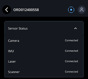

  • A sensor status for the Orbis scanner is now available in Stream Device Option section. It will help you to make sure that the Orbis scanner is set up correctly and working.
  • When you tap an available device, a page with further sensor status details will open, see figure below.

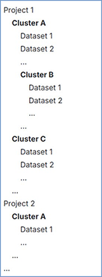

Orbis Changes
  • Stream 4.2.0 requires a mandatory Orbis firmware 4.3.0 update (and vice versa). Both must be installed together. Existing projects are migrated automatically. Create a backup of your data before updating.
  • Sheets are deprecated in favor of Clusters to unify projects across all FARO scanners.
  • The Orbis scanner now supports the hierarchical cluster structure used by Focus and Blink scanners for consistent project handling. Sheets are no longer available and have been replaced by Clusters. For more details, see the Stream or Orbis manual, available soon on the FARO Knowledge Base (https://knowledge.faro.com/)
  • Improved processing options for Sphere.
  • The USB data structure has changed. *.geolsam files are no longer presented in a single flat list. Instead, they are now organized into subfolders by project. As a result, Connect users will need to navigate one or two levels deeper to locate the files for processing. See Figure 1.
  • For customers who access Orbis datasets via a direct Ethernet or Wi-Fi connection, updating to Connect 2026.0.0 is required. This version is necessary to maintain compatibility with the new Datalogger firmware.
file structure example
