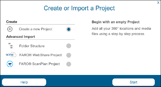

  1. At the Project Portal screen, click +Create.
  2. Type in a project name and press Enter.
    Note: The name can only contain standard alpha-numeric characters.
  3. Choose to create a blank project or import available projects, and click Start.
  4. A tutorial panorama is displayed that explains how to build a project.
