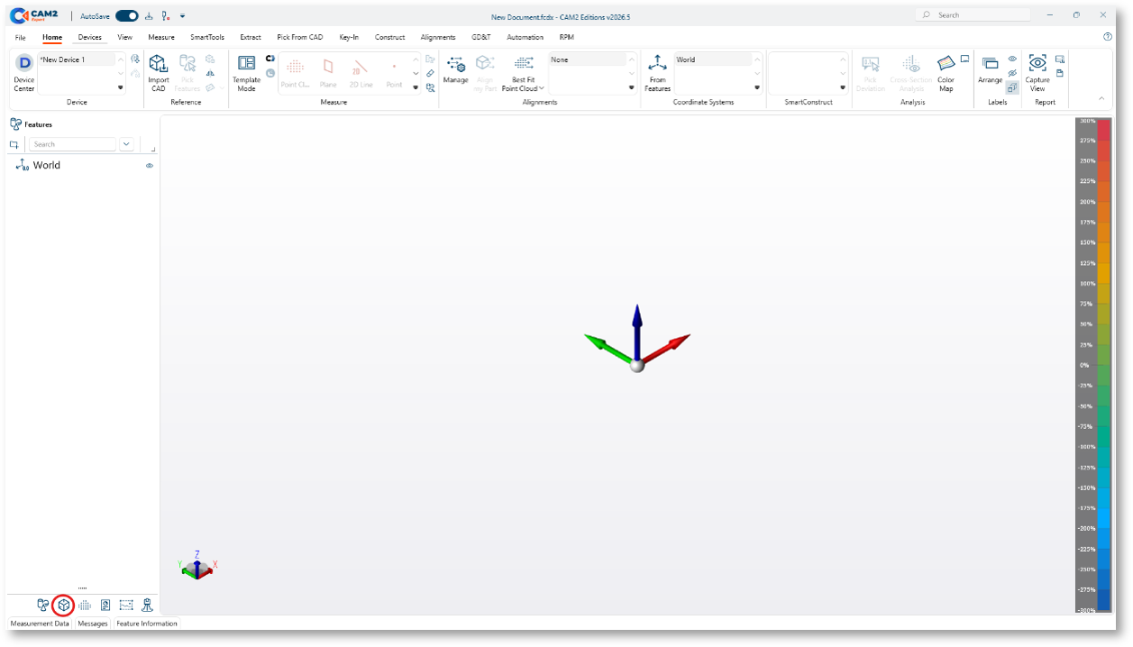

  1. Open your CAM2 software.
  2. Click hideincadICON10.PNG CAD tab at the bottom-left of the interface.

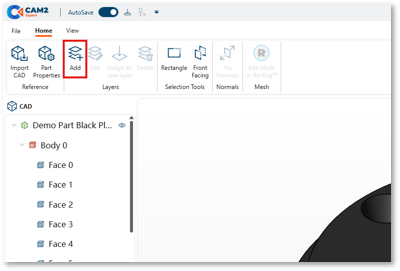

  5. Click Add on the ribbon to add a layer.
  6. Name the layer and click OK.
  7. After created, the layer folder will be above the CAD file name, as shown below.

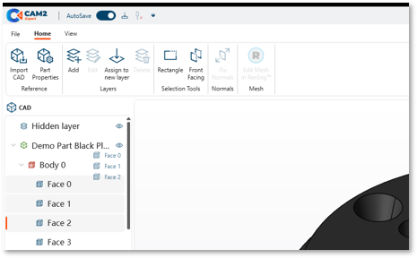

  8. Option1: Select and drag-and-drop the Faces you'd like to hide into the new layer folder.
    Tip: Hold CRTL + select multiple faces and then drag-and-drop them into the layer folder.
    Option 2: Using the left mouse button, select the required surfaces by clicking directly on the CAD model, then right click and select from the options:
    Tip: Hold CRTL + select multiple faces.
  9. To the right of the layer folder, click the eye hideincadEYE.PNG to hide the Faces you placed inside the layer folder.​​​​
  10. You should now see the Faces you've hidden disappear from the CAD model, as shown below.
