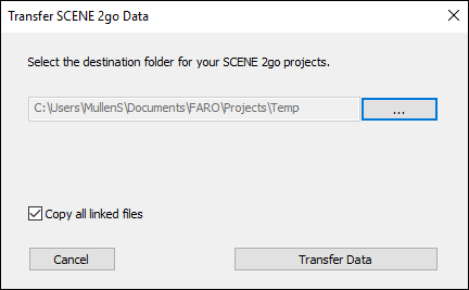

  3. To view your map, click TransferSCENE 2go Projects in the SCENE 2go submenu.
  4. In the transfer window, click ... to designate a destination folder and click Transfer Data.
  5. When the transfer is finished click Open in SCENE 2go to view, or click OK.
