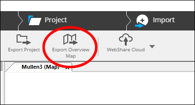

Exporting an Overview Map
  1. Click Export Overview Map in the Export ribbon.
  2. Overview maps can be exported as TIF or DXF files for use with 3rd party software.
