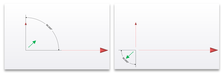

5.    Angle from Features Improvements
(All editions)
Angle from Features has been enhanced to offer additional angle options during creation. Users can now define Acute, Obtuse, and Reflex angles using either two features or three points. This functionality is available in both the main 3D mode and Cross Section Analysis.
Once created, the position of the angle can be manually dragged and positioned by the user:
Note: dragging the angle across the angle apex, will display the opposite angle.

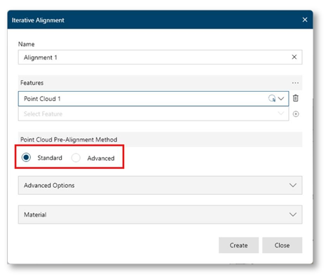

7.    Point Cloud Best Fit Alignment: Advanced Method
(Expert, Scan Professional, Analyst editions)
When enabled the ‘Enhanced Point Cloud Alignment’ experimental Feature will expose 2 options when performing Best Fit Point Cloud Alignment:
  • Standard Method: the existing alignment approach used in CAM2 2026.2 and earlier, and creates a quick alignment, which works for most parts.
  • Advanced Method: designed for more challenging parts where the Standard method may fail.
  • This method  takes longer to process, as it performs the following steps:
    • Executes multiple alignments in parallel using different parameters and algorithms
    • Applies several geometry “flips” to account for symmetry
    • Evaluates results using multiple statistics and heuristics to automatically select the best alignment
These alignment options are also available within the Iterative Alignment user interface, but only for alignments that consist exclusively of Point Cloud data.

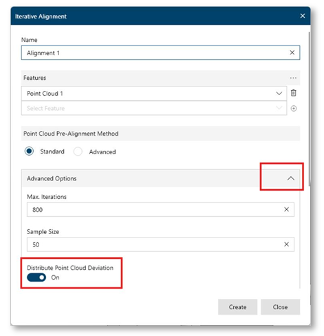

8.    Iterative Alignment: Distribute Point Cloud Deviations
We have introduced a new advanced option specifically for alignments that only contain Point Cloud.
  • Distribute Point Cloud Deviations: this option is particularly useful when aligning cast components to CAD models of the final machined parts, where there is a size difference.
When enabled, this option further refines the alignment by attempting to distribute residual errors evenly across the scan and CAD model.

Directional Sign Option for X, Y, Z Lengths
When creating the lengths between features the  ‘Display directional sign to X,Y,Z’ option will indicate the direction between the first and second feature, relative to the active coordinate system, when checked.
This capability is useful in certain workflows, such as Roller Alignment, where users need  to compare the fixed end point to an adjustment end point of a cylinder, relative to the active coordinate system.
The coordinate system is typically set by the main drive rollers, and by checking the end points of subsequent rollers using the Directional Sign option, users can understand how much to adjust the rollers in each direction, to ensure this are parallel to the main drive roller.
NOTE: When this option is enable only a ‘-‘ sign is shown if the length is in the negative direction of the coordinate axis, e.g. -8.22mm. Any positive direction will have no sign prefix e.g. 2.26mm.
