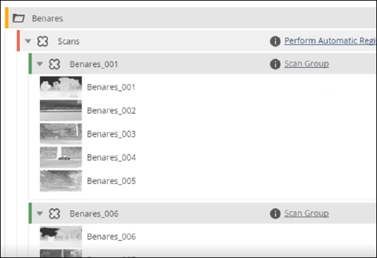

  5. Open SCENE 2018 and transfer the scans to the PC.
    Note: Scans will appear in groups automatically in SCENE.
  6. Complete normal target-based processing and automatic registration.
