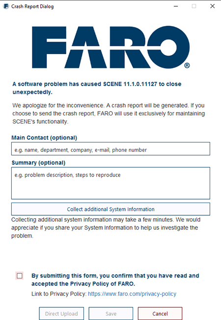

In the Event of a Crash
After a crash or an unexpected SCENE closure:
If the Crash Report Dialogue opens:
Example of the Crash Report Dialog
  • Click the Collect additional System Information
  • Accept the Privacy Policy of FARO
  • Save the file on your Desktop
  • Send the file to FARO Support
