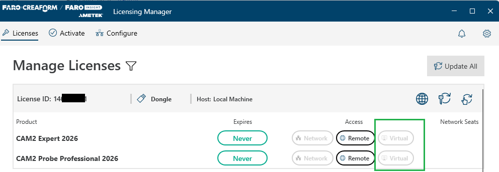

  • The Licensing Manager app was incorrectly showing the Virtual Access option as enabled for dongles. Since Hardlock licenses cannot be used on virtual machines, this option should be disabled for dongles. This has been fixed in this release

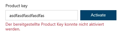

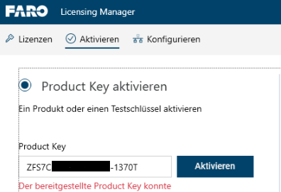

  • In some cases the installation/update of the Licensing Service would succeed even if HASP Driver wasn’t installed/updated as expected​. In this version we are validating that the expected version of the HASP driver is installed, if not, the process will visually show the failure
  • The displayed of an error message in the License Activation window of the Licensing Manager app, was not being displayed correctly: “The key provided could not be activated.” It was particularly evident in the German language:
    The message is fully displayed in the current version:
