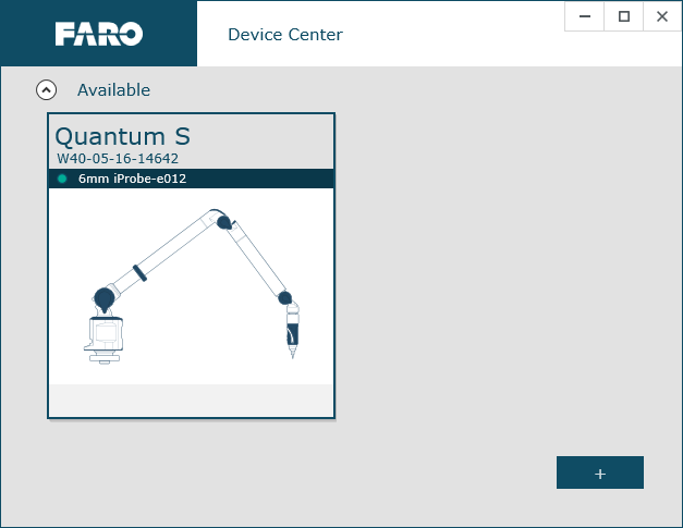

CAM2 2018 and Later
  1. Connect your FaroArm with attached LLP to the computer using the USB cable.
  2. Turn on the computer and the FaroArm. Make sure that all applications are closed and nothing is communicating with the FaroArm and LLP.
  3. Open CAM2 20YY.
  4. From the ribbon, click Home > Device Center. The Device Center panel appears.
  5. Click on the FaroArm with the LLP attached. The Device Information panel appears.
  6. Click on Manage. In the All Probes group, look for the tile for the LLP connected to this FaroArm. Click on the green Connect icon in the upper-right corner to update the information.
  7. Click on the Edit pencil icon in the lower-left corner. The details for this LLP appear.
