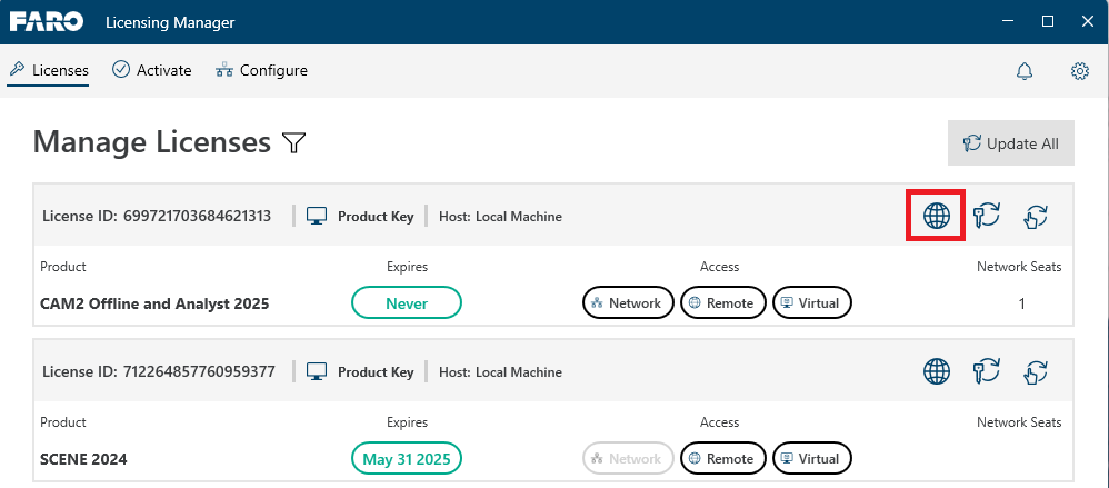

  • Each license listed on the Licensing Manager now has a button that redirects to the Web Portal License Information page. With that, the user can more easily find detailed information about the license

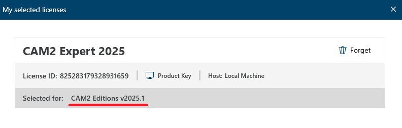

  • Settings panel on the Licensing Manager  - Forget my license selection - The “Remember my choice” option of the License Selection Screen allows customers to select and save the license they want to use to run FARO software. The licensing manager has now a settings panel, with a button to see “My selected licenses”.
    Clicking on the button opens the “My Selected Licenses” screen, which allows customers to delete the saved license selection for a given software product.
