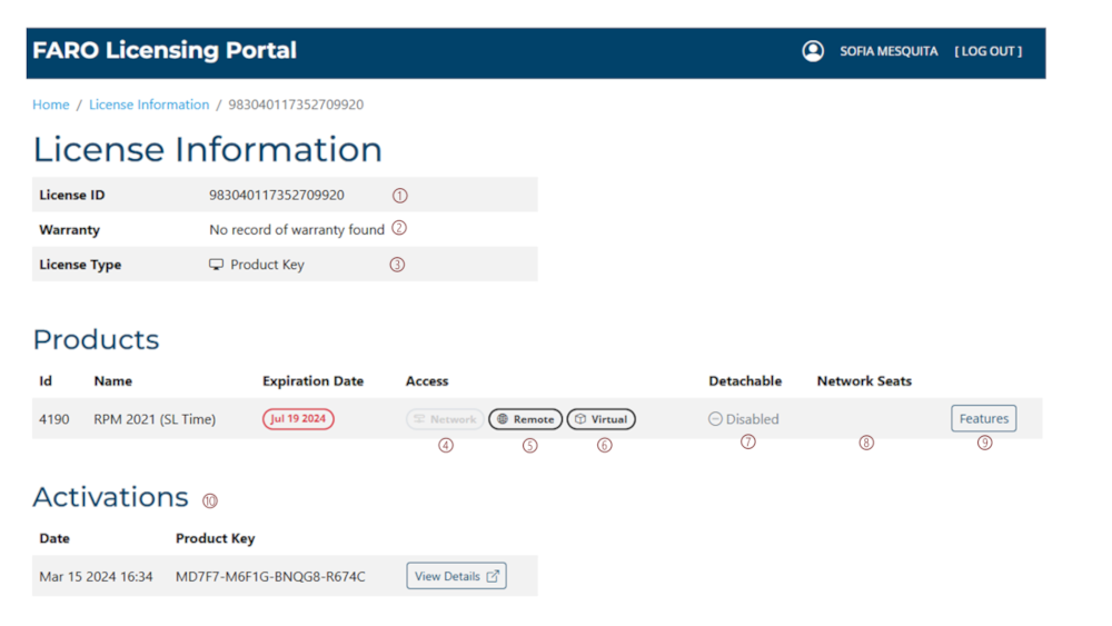

License Information
This is a functionality of the web portal that allows you to see information about your License. It can display the information about the license itself if you enter the License ID or the C2V file of the license. It can also show you details about a given Product Key if that’s the information you entered.
  1. On the Portal homepage, click the License Information panel.
  2. On the next screen provide either your Product Key, License ID or your C2V file (used for the offline activation or license update).
    If you are not familiar with these terms please read carefully the Licensing Manager App article.
  3. Click the SEARCH button.
Depending on the information provided you will be redirected to one of these screens:
  • License Information - If you entered the C2V file or the License ID
Definitions
① License ID - The unique Sentinel LDK-EMS key ID;
② Warranty - Until this date the customer is entitled to updates of the license product;
③ License Type - Licenses can be of the type “Softlock” (Products Keys) or “Hardlock” (Dongles);
④ Network - If enabled the license is accessible through the network;
⑤ Remote - The license is accessible by remote desktop connection;
⑥ Virtual - The license can be used on a virtual machine environment;
⑦ Detachable -  If enabled, the license can be detached from the host computer to the client computer;
⑧ Network Seats - The number of seats available on a network license;
⑨ Features - The identifiable functionalities of the product contained on the license;
⑩ Activations section - Shows the date of the Product Key activation and the Product Key itself.
