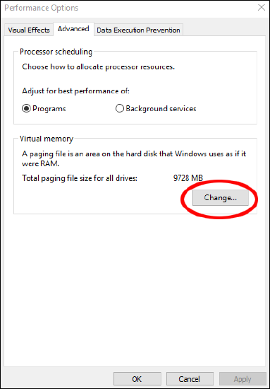

Windows Paging File
The Windows Paging File is hard drive space allocated for Windows to use like RAM. Make sure it is enabled and properly setup for your PC.
  1. Access the System window in Control Panel. Through one of the following methods:
    • Open the Control Panel and click System and Security/System.
    • Right-click the This PC ThisPC Icon.png icon (Windows 10) or the Computer Computer-Icon.png icon (Windows 7) in File Manager and click Properties.ControlPanel2.png
    • Press Windows Key + Pause/Break.
  2. In the System window, click Advanced system settings.
  3. In the System Properties pop-up window, click the Advanced tab. Click the Settings option under Performance.
  4. In the Performance Options window, click the Advanced tab. Click Change, located under Virtual Memory.
  5. The next screen displays the system's Paging File settings.
    Make sure the No paging file option is not checked and make sure the Currently allocated memory size is more than the Recommended memory size.
