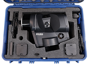

How should I package my equipment to Faro for service, calibration, or repair?
  • Please ensure the device is packaged securely in the original Faro shipping box/container. Here are a few examples of what these can look like:
    • Laser Tracker
    • FaroArm & Gage
    • Laser Line Probe
    • Focus Laser Scanner
